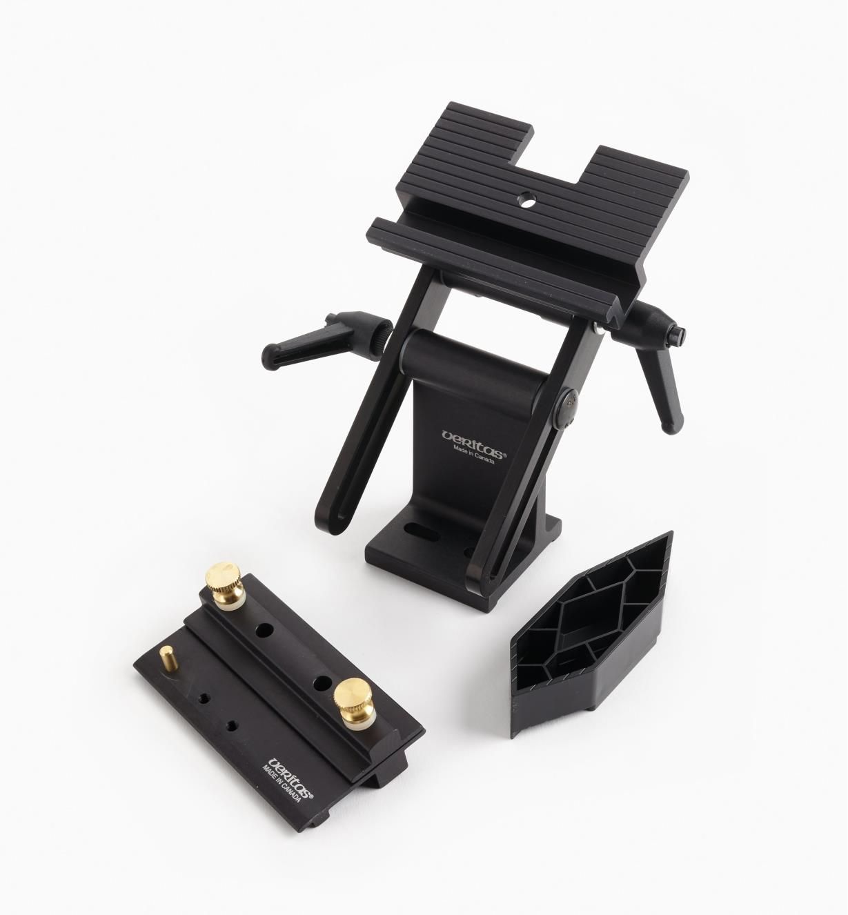

This one is homemade but from plans, I bought from eccentric engineering. It works, but does is finicky to set-up for one single grinding job. I adapted a holder to accept an ER collet set I had. I like the table design I made a second one and scribe some angles on the tables has guides. Your Lee Valley base looks equally useful.

Wow, now that is cool. Kinda like a drafting table mechanism, I like it.
That looks really cool!
But it's not immediately obvious to me how you use that. Can you describe it a bit for us?
