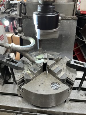

The hollow mill cutter has a large relief bore behind the flutes. I don't think they're really designed for a plunge cut like an annular cutter, but are more for machining a slightly oversized shaft to finish outside dimension on a part that you can't machine normally, like with a boring bar.
In the photo is a pair of extractors for a side by side shotgun. The two halves would be soft soldered together, then the hollow mill would machine the 'tail' to proper dimension, then separated. As you can see, the tail is 2.75" in length, and there's no way you're going to fit a boring bar between the 'tail' and guide pins. And the tail would be too flexible to cut with a single point tool.
The smallest annular I've seen is 7/16", so the hole is? 1/4"? The one I have is 3/32"
The small one I made is to face the bottom of a front bead slightlt so that it will point straight forward.
