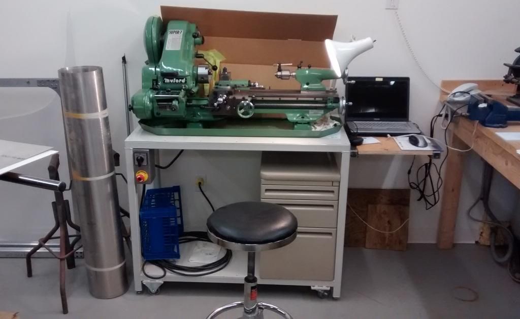

I saw the discussion in the Welcome post by SomeGuy about the stand for his lathe & thought I'd share what I did for my Myford which was similar. Instead of thread drifting his post I'll put it up here.
Anyhow, here's mine, 1 - 1/2 square tube with a repurposed metal desk drawer set and eventually a backsplash. The side shelf was a re-design so it's not painted or finished in those photos, it was originally a pull out shelf above the drawers but it was in the way. It drops down when not needed.

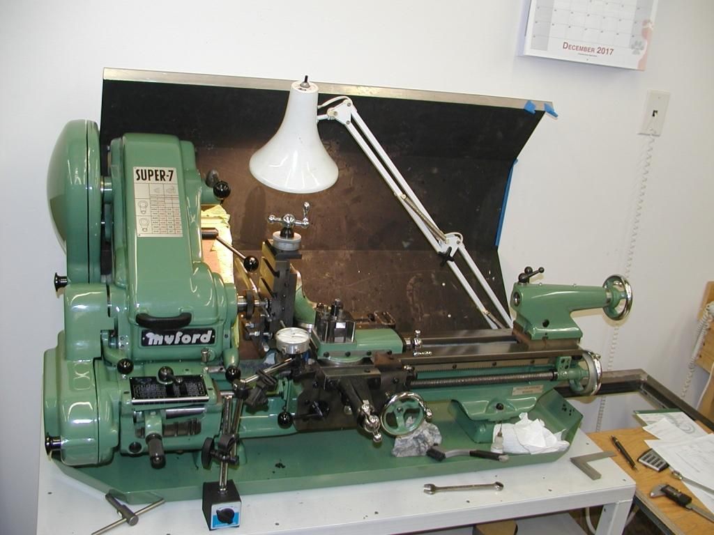

So, here it is as first built complete with rapid prototype backsplash (the chuck key doesn't really live there, actually the usual chuck is now a keyless):
And after the back splash was put on. The back splash tucks into the (rather cheezy) Myford tray that does a so-so job of containing the oil dripping from the gearbox and saddle but is pretty good at containing chips.

It's not clear in the photos but in addition to the casters there are jack bolts at each corner to level & steady the stand.
Last but not least I put an E-STOP on the unit for an added level of safety.
