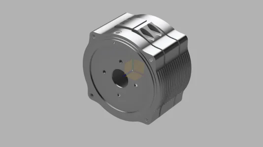

I have a component that I have modeled. I'm looking to have this sent off and machined but I'm not sure I understand machining tolerances etc.
There are a few things like the 4 peripheral mount holes, central mount holes, center bore that need to be maintained within a reasonable tolerance.
This is where my understanding of tolerance falls apart.
The largest dimension of this unit is about 97mm
If I get it machined to a tolerance of 1/1000 then the largest dimension of the bolt holes should still working out...
...But This can't be how things work out. This would mean that any part that needs even slightly better tolerance over a certain size would not be possible to manufacture.
...So this is not the correct understanding. There must be a level of tolerance lower than 1/1000 that would get me a component that still fits well within my needs.

Another thing to look at: are there components within /with which your part interacts? And how is that interaction. For example: is there a shaft inside a bore that needs to be a sliding fit, a close tolerance sliding fit, a non-moving locating fit, a press fit, or a shrink fit?
In other words, tolerances depend on the application as well. And you can have different tolerance specs within the same part. Some parts are made from a casting - so the outside can be -/+1/8” or more and yet contain features that are within 1/10000” or better. Gear box housings come to mind, as an example.
Just a sort of flippant comment after spending a minute looking at your item....from a "hobby machining standpoint" the most relevant tolerance issue may quite well be the "frustration tolerance" you personally have....In my case I may just throw a few tools around the shop or a couple through a window before I begin....just to get that formality over with right away....

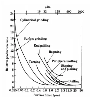

Then there is finish which is yet another spec (and cant contradict dimensions), but leave that topic for now.

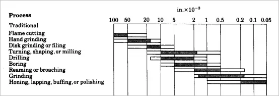

Its really easy to get if you understand their function. Nothing made is "exact", there is always variance. Tolerance is just defining the acceptable limits of the variance . Say a shaft needs to be a sliding fit in a hole. 1" nominal diameter. You could state the diameter as 1" dia, + 0.000" -0.001 and the bearing ID at 1.001" -0.000 + 0.001 (or 1.000 +0.001 + 0.002, conveys the same thing). if the shaft and bearing were made to those tolerance (the actual measurement was in between the allowable limits of the tolerance) you get sliding fit guaranteed to have .001 - .003 clearance. If you need the clearance to be more exact, you tight up a tolerance
As practical matter, for any given dimension, smaller tolerances cost more - either money if you paying for it or time if you machining it. So good design means to only be as precise as you need to be for each dimension.
You'll also find that most correctly done drawings don't have one tolerance. There often ranges of tolerances specified in call out and there conventions such as the number of decimals displayed convey the tolerances. For example, a large fabrication might have a 1/16

And similarly I've seen where a 'typical' surface finish is referenced. But what they might be indirectly saying is their selection of tooling typically yields X finish so that's what you unless there are stipulations. This really needs to be examined closely depending on the application because you can have combinations of surfaces that are on spec but don't make sense in real life. For example curvy mold surfaces that are contour milled & show toolpath stepover. So best to convey end use & ask lots of questions along the way & hopefully teh shop will work with you as opposed to take your money & say this is what you asked for.

I have an electric motor on my mountain bike. The cycloidal gear reduction was damaged and I needed to mate a new reduction unit(planetary) to the said motor. Which means I need to create a brand new housing for the motor onto which the new planetary reduction can mate. That's what this piece is.
In that case you may want to provide both the motor and the planetary to the shop so that they can check fit/tolerances for the mating parts and make your adapter accordingly.
