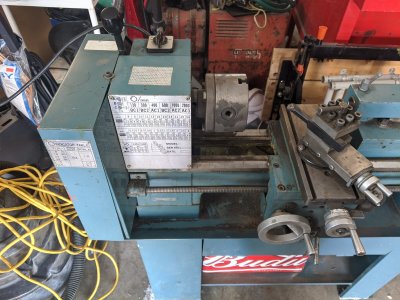

Hello everyone. This is my first post as I am just joining the world of machining and metal working.

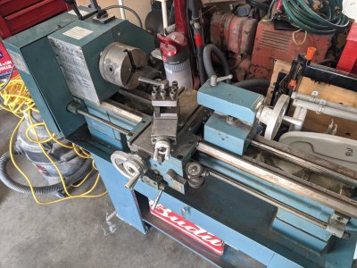

I recently bought a small hobby lathe as the price was right and everything seemed very sound and in good shape.
However I have had no luck in researching the make and model. It was imported by a company out of Winnipeg which doesn't seem to around any longer. I had hoped that maybe some of you that have in the game longer might recognize the lathe and be able to point me in the right direction.

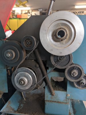

Besides just a manual I do need a belt for it. It has a skinny v-groove belt that runs from the drive to the spindle but there is also a different pulley set for lower speeds. This looks like it would be driven by a toothed/cogged flat belt and you switch the v-belt onto it when you need to slow down.
I am attaching some pictures. Any help is appreciated.

Having some dimensions would be helpful, maximum swing diameter, distance between centers as examples. But it's probably either a 8" -9" swing lathe. These were originally cloned from the 8" swing Emco Austrian made lathes. http://www.lathes.co.uk/emcocompact8/ I'm unsure if the user manuals on the grizzly website go back far enough. But at one time they did sell a very close copy of what you have. If there's a tag still on your motor it might indicate it's country of origin, very likely that will be either Taiwan or China. A word of advise, the less you know the more careful you'll need to be for your own safety and for preventing machine damage. If it were me? It's pretty easy to see that lathe has been neglected and likely misused at least a bit. I'd start with a complete and thorough detail cleaning. I'd bet that 3 jaw chuck has never been cleaned since new and it's likely a bit stiff with chips and old congealed oil. Carefully disassemble it and especially mark the chuck pinions and holes for them on the chuck body so your sure everything goes back into where each part came from. If the chuck was well made, the jaws tips were ground after it's first assembly. So each pinions location helps to preserve any accuracy the factory built into it. My Emco heavy duty chucks are quite specific in the user instructions about those pinion locations when disassembling the chucks. One way to tell if that is a well made chuck, look for a O mark at one of the chuck pinions, that's what is normally referred to as the master pinion, and it was the one used to tighten the chuck to then grind the jaw tips for concentricity. If it does have that O mark then that's the pinion that should be used for the best concentricty when tightening the chuck each time.Some insist on using grease to lube a chuck, but it traps those metal chips inside. I've found even way oil to work well enough although you will get a bit of spray out of the chuck the first time it's run up to a higher speed. And pulling chucks apart for that cleaning and re-lubrication is a standard maintenance item at least every year or two or more often if you can feel the chuck starting to bind up with chips inside. Through drilling and boring parts is what causes most of the issue since centrifugal forces as the chucks spinning helps to drag those chips into the chucks internals.

Thank you Pete. You hit the nail on the head. That is it. Thank you for all the info.

It is missing the toothed belt so I'll need to look to buy one of those, though perhaps the guy I bought it from will still have it. He has been bringing me extra things as he finds them and he may not even know the belt is for that.
I see already by searching the Emco model that there are a number of rebuild videos out there I'll have to take a look at.
