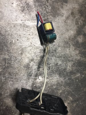

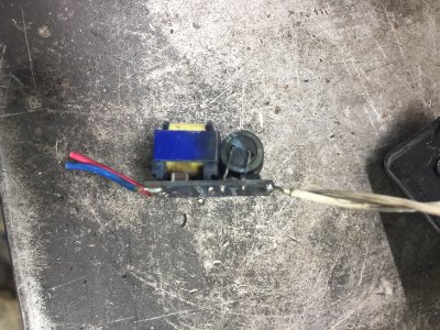

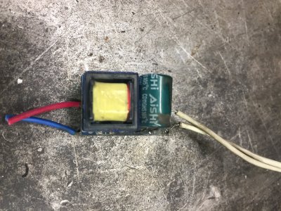

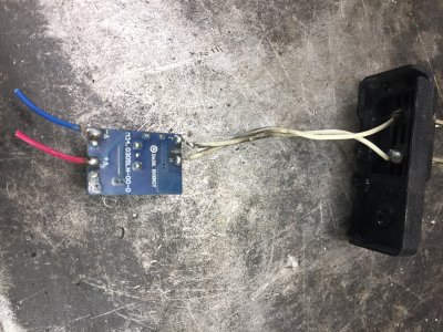

I picked up an used LED work lamp this morning and this little thingimjig appears to be burnt out.
Is this a commonly available piece that can be purchased or am I out of luck?
Thanks

If you can count the number of LEDs it should give you and estimate of the power supply voltage (if they are all in series) about 3.5V per LED typically (varies from 2.8 up to 4V). Current is probably 20-30ma, assuming they don't have groups of LEDs in parallel, then 20-30 per group.
That's a very unsafe looking power supply.

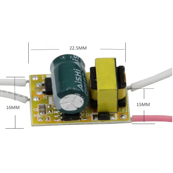

Joshua great googling, I don't speak Russian and did not try the translation feature but looks like an excellent link.
Skippyelwell.....Probably just don't leave it unattended and assume the low voltage leads may be low voltage across them, but might be at hazardous voltage WRT Earth if the little transformer is iffy (many are because most (90%) of these make them for pennies transformers from China are not wound with the important safety requirements that are required for a certified product in Canada.
