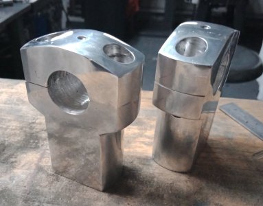

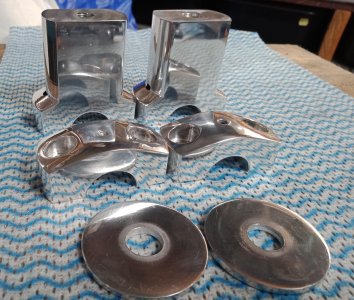

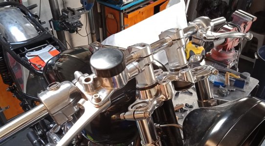

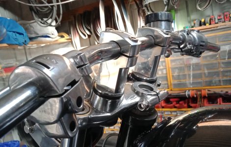

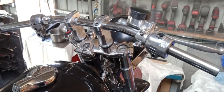

I decided on flat, drag bars on risers for the bike, so bought a set of drag bars and looked around for some risers. Couldn't find any I liked, so I made my own. I started off with two slabs of 25mm aluminium, chucked them in the four jaw and turned them to the shape I wanted, then turned them around and drilled and tapped for 10mm mounting bolts. I then drilled a 7/8" hole for the bars, drilled and tapped 8mm holes either side for clamping bolts, then mounted them on a vertical slide on the lathe, mounted a .8mm slit saw in the chuck and cut through to remove the caps. The caps were then counterbored a little for stainless Allen head clamping bolts and I also spun up four 3mm thick aluminium mounting washers.
Quite happy with the results!

Those look very nice! From the pictures it looks like the surface finish matches your other parts perfecty, almost like its OEM.
