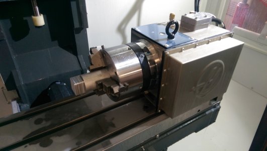

This is the one I have for the Haas I believe it was $10,000 with tailstock and extra for the drivers and program but as Janger said the pi** off is what fusion charges for the access to the cad program although I hear it can be purchased monthly, I also have a version of Bobcad that I believe can make it functIonal but I’d have to check.
