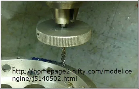

Back to your question. I don't thing the point like the tap on the left can be used, or at least it would be a clunky device. You can either
- put the tap in your chuck jaws, drive it in under lowest speed for a few threads to engage, release chuck & hand tap the rest of the way. This takes a bit of feel, don't do it on your prize possession first attempt

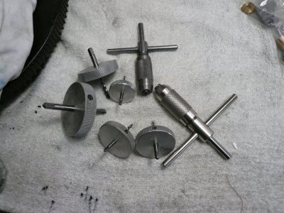

- make a knob tap holder like pic. Here the chuck jaws are just loose enough so you can rotate by hand but its being guided on the shank. These give an excellent feel which is important on small threads. Unless you are tapping really hard steel, there is enough leverage on the knob to cut threads. I'm suspect the tap shank might have to have a new flat ground for the set screw, just with a Dremel or whatever
- an extended shank holder. Similar concept to the knurled knob but with a cross hole for a tommy bar. I'll be making some of these shortly so stay tuned.
- they do make conventional tap holders with an extended pilot rod that you can similarly guide in a chuck or better yet sliding in a collet or holder. They work perfectly fine but they use more Y-axis real estate, probably 4-6" with a tap in there.
