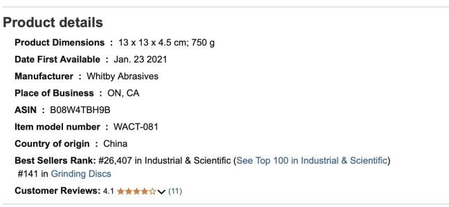

I've been on a search for aggressive grinding disks for my small grinders. For the large ones it's the pipeliner disks at P.A.
So these ones which are made in Whitby, ont are worthy of reordering for me. At least I think they are made here, but could be chinese.
These are soft and always open up fresh abrasive to the cut. They devour metal.
If you want a grinding disk that will last 20 years, don't buy this.
You had me excited for a bit, but sadly, COO = China
