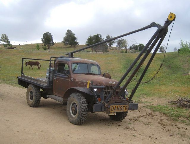

I've been thinking about building a gin pole crane for my SxS (Yamaha viking). I don't need a huge lifting capacity, maybe 300-500lbs or so, but it sure would be handy for a 3rd hand for flipping weldments and stuff out in the backyard and also moving derelict machinery stuff around. A mobile all terrain lifting device if you will. The viking itself weights about 1300lbs. Having gone through some disc issues over the winter, It's time to start working smarter, and not go down that road again.....I have an old tractor for heavy lifting, but it's big and cumbersome to maneuver (and currently not running). Something like this would really fill a niche for the backyard, and worth it for the versatility and control.
I'm going to be building a subframe for a plow at some point before next winter so being able to tie into that would be handy, and now would be the time to design around that requirement. I'd also like to build a front rack/bumper for it, so this is an opportunity to incorporate some added functionality while the slate is clean.
Anybody ever built one, use one, heard about something similar? I know on a SxS the capacity wouldn't be that high, and the last thing I want is to start bending and breaking stuff on the viking, but knowing that, it would still be really handy to have regardless. Would be nice to hear from people who built/used them and talk about good features to have, and others to avoid.
For picture sake, this is what I had in mind. I've seen others with just chains holding the a frame angle, so that it's adjustable, and I like that feature for the variability of uses I might have. I've also seen them with extendable booms too.

A gin pole loaded with 300lbs on the front of a sxs will no doubt squat the front end to the ground, boomed out far enough with the right amount of weight could endo the thing
It's do-able, how much weight it would take to endo it, I'm not sure, probably not much

Yeah, I figured it would squat it pretty good, and the potential to lever the rear wheels off the ground would be pretty easy, but it sure would be handy for lifting things like the mower deck, and other stuff in the 100-200 lbs range I work on around here. The viking is pretty rear weight biased with the engine under the bed, and I could always counterweight the bed too, but certainly don't want to overload the front suspension.

Sigh.....you guys understand torque calculation, ie ft lbs = lbs x ft from pivot point.
So simple version, front wheel axles are the pivot point, distance to the lift point in front of the wheels is the distance x the weight.
Counter balance is front axles pivot point distance to the rear axles x the weight on the rear axles.
As long as this number is bigger it won't tip over. If its less endo!
You can get more technical and figure out a lot more but this is only first semester engineering.

The picture of the truck is great, do the 2 donkeys come with it? However, myself would want the gin poles on the back, possibly moveable long the back deck. Rig to lift and load onto the deck if needed for transport. Many front ends are not as strong as the rear ends capastity wise.
Take a good look at the frame of your SxS, a lot of them are not very thick/heavy material. Stamped sheet metal in a lot of cases, full of lightening holes. High strength, maybe. Perhaps a general rule of thumb, see if you can get heavier springs for the suspension. you are at the "normal" load limit when springs are bottomed out. Anything more, frame, suspension, axels, which one fails first?
Lots of units with home made snow plows, a lot of very well made units. OVER built, much stronger than SxS frame/ mounting points.
