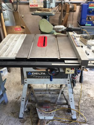

Because of lack of room I've had to store my table saw out in the storage tent, however before it goes out there I soak the table with any kind of oil that is handy, a thick film is needed then Saran Wrap over top pushing out the air bubbles, then a layer of cardboard on top, a couple of turns of packing tape and it's good for the winter.
I've left it like that for 2yrs sometimes and the surface is perfect when the Saran wrap is removed.

Ya, I can see that working quite well on the table surface.
But what about the motor winding, shaft, bearings, the electrical, the miter gears, wheels, axles, underside, sheet metal....

Actually it spends all of its time out in the storage tent unless I bring it up to the shop to cut wood, never had a problem with it. The adjustment screws all well greased.
I'm north of TO so it's humid in the summer but probably not as bad as where you live.

The only reason the Saran wrap works is the oil contacts the whole surface keeping air out and not letting the oil evaporate, not sure finishing wax is going to do that.
