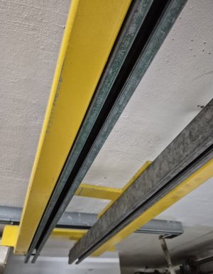

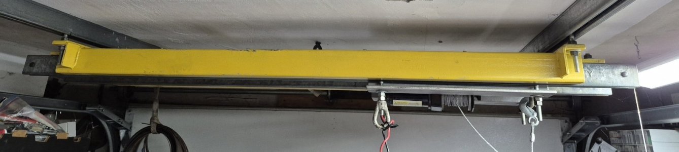

I'm sure it'll be fine if you use it within reason. Do not side load that at all, as you'll risk spreading the strut. I would love to have something similar in my shop for those awkward things that are just hard to lift and manipulate single handedly. A few of the next couple projects for me are going to be lifting device related, as I'm not getting younger, and the projects seem to keep getting bigger. Of course I said that last year, but other stuff just keeps wiggling it's way into the queue ahead of them. Damn line jumpers.....
Looking at that, the only thing I'd possibly add, which is just me overbuilding/overkilling it, would be some triangular gussets to the mounting plates to keep the strut from potentially spreading if side loaded. Needed? probably not. Worth taking the whole thing down to do it? Probably not either.

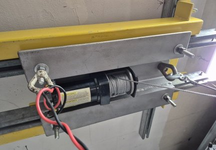

No need. These are plenty strong and stiff (1/4 inch thick). Silly me thinking I could hang the brackets first and then try to twist the rail in...not a chance. They all had to be slid on first and then I bolted them to a plate that I had first mounted to the joists. I didn't have the room to slide the rail in after everything was mounted so this was my only way.
Ya, strut is pretty stiff stuff. The gusset suggestion was me just being nitpicky lol. I DO wonder how much side load it would take to actually spread one and spit the carriers though.......Most likely north of the hoists capacity I'd bet.
Yup, was aware of these brackets....would have had to figure out how to get threaded rod hanging down from the ceiling first before putting this up, it's the only way that style bracket will work. That's why I just welded on my own so I could bolt from either side, and it had the advantage of keeping the track from being able to rotate.
without running the numbers, or seeing your exact setup, it is almost certain that if it fails, the 2x6 joist will split along the grain near the end of your lag screws. when that happens, the load will move to other joists and a loud crack or popping noise will alert you.
the real danger in a system like this is that if that happens, but you aren't around to know or don't fix it, and then lift something else heavy later, it sill start to fail in increasingly dramatic ways. Probably it will take several of these events for it to completely fail, but it would be wrong to say that those loud noises don't matter because they have happened before 😉
The problem is that while 2x6 SPF is quite strong when it supports a load distributed over it's whole length, point loads are particularly bad for wood. And a lag screw that goes only part way through relies on the cross-grain strength of the wood - which is much less than along the grain because of the way trees grow.
then you have lag screws that are close together. Each one produces a 'cone of influence' within the wood that starts at the tip of the screw and gets wider towards the bottom of the joist. if those two cones overlap, then the wood in that overlapping area has to support weight from both screws. the anisotropy of wood (the difference between along the grain and cross grain strength) makes these cones particularly wide and checks and knots makes them unpredictably wide.
to bear the load at all, the joist has to bend. That's how it can develop a reactionary force. The bending creates tension in the bottom part of the joist and compression in the top part. but it also creates perpendicular forces - forces that run across the grain.

On the surface, this design looks more than good enough. And I think you will be fine for moderate loads. So I'm not being critical here, but:
You have significantly weakened your joists near a stress riser (the I beam). While your unistrut can likely handle 400 lbs, you need to be sure your joists are okay. By avoiding all the drywall work, you cannot say with confidence that the lag bolts are centred, perpendicular, and didn't split the joist during installation
What appears to be simple and reasonable can have catastrophic results. Look up the Hyatt Regency Walkway Collapse.
Now for the good news. I see you put a lot of thought into your design. It appears to be very well done! it certainly is very clever.

Yup, there is risk with the way I lagged things in, have been aware of that from the start of this project, and part of why I liked going with the plates and 16 lags to hold it, even if I missed on a couple of them or had a split, the rest would pick up the slack (since unistrut can handle spans on its own). At one point I considered opening the ceiling and getting metal up above spanning the 2x6's and dropping supports down through the drywall...ignoring the pain of drywall work, I was also concerned with what this would do for the fire break it is supposed to provide if I had holes through the ceiling like this and then also how to deal with lateral movement not just tearing up the drywall and making the holes worse. I also considered putting a ground supported beam all the way across, but when I started doing the math, the beam was getting quite big and I'd have lost a lot of lifting height.
It's definitely a bunch of trade offs...at least it looks as though I didn't do anything overly stupid.

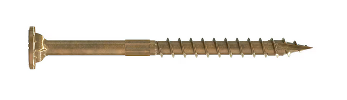

Not an engineer, but I've spent the last 40+ years arguing with them. If I was doing this with the construction screws you used, I would do a test of the screws. Grab a chunk of 2x6, a u-bracket, some wire rope, a nice solid bench vise, and your scale. Screw the bracket to the 2x6, put the 2x6 in the vise, wire rope between bracket and scale, and use a comealong to a suitable fixed anchor. Pull until it fails, if you can. Now you know roughly how well the screws will support a load. Derate 3 or 4 to a safe working load. My guess you will be surprised by the strength of the screw/wood connection, either way higher or way lower than anticipated.
