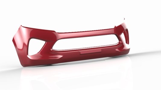

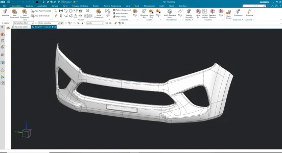

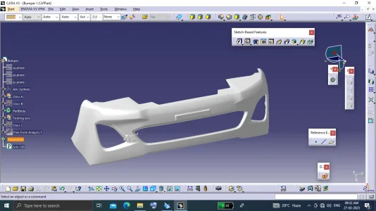

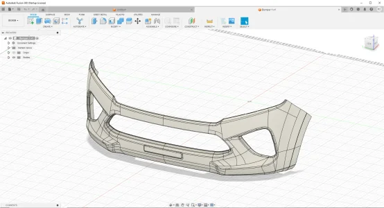

I was looking for a little challenge today. I want to Grabcad to find a plastic part to work with to keep up with mold design-surfacing skills. I came across this facia that is drawn in Catia (linked below). I then tried to import it into my paid software packages. Well of course, both Mastercam and Siemens want more money for that module. WTH, I though well lets see if it is possible in Fusion 360. Long story short... here is the screenshot.. Also proof with it into NX
So my evaluation so far of whether I will pay Autodesk is YES, because of..
1/ translators
2/ 3D machining capabilities, and umpteen million posts
3/ fastener library
Merry Christmas!! a free part translator.. (well, 150 for 3 years almost free)...
Next, now a partingline shall become.... Thanks to Autodesk, GrabCad, and the part designer (Nishanth kumar)

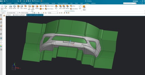

Matt-Aburg

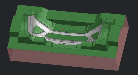

V2 Updated partingline (more to go)
Partingline sweetened.. small undercuts removed... all derived from part geometry, no sketches..

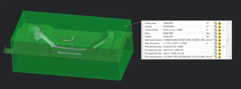

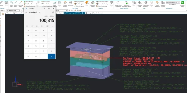

Matt-Aburg

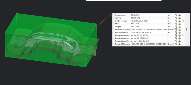

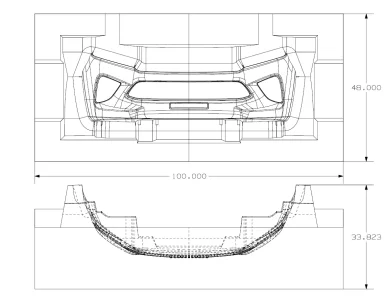

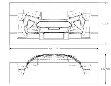

V3 Updated partingline
At this point partingline is simplified by adding flats and locks. This is at the level where this would be going for block approval.. On big blocks like this you need to get Iron ordered ASAP. Goal is while it is in transit, the design gets finished. These blocks are starting out at 46,000 pounds.

Nice CAD work. Would these be cavity type molds for plastic type injection or do they press/shape some kind of sheet stock material?
Matt-Aburg
This is a Plastic Injection Mold. The other type you asked about is called Compression Mold. Compression is more commonly used for rubber like material or thermoset plastic.

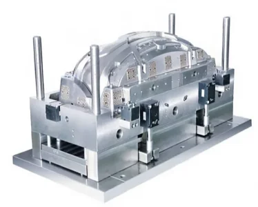

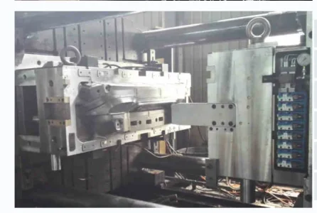

Quick update. Raw material for entire mold not including machining on plates is over 100000 pounds..

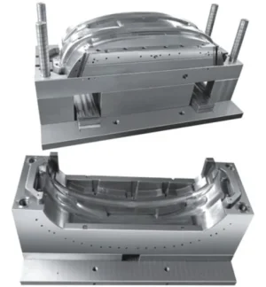

Also, here is a screenshot of similar steel from a company that really makes these monsters..

Do they ever repurpose mold blocks like that to utilize the material when designs get changed or become redundant or whatever? What would be a typical alloy?
Matt-Aburg
A part change, they might be able to make an insert or weld it. If its too big a change, it would scrap the block. The block have many holes drilled in it for water and other things, so not so easy to do anything major. I would think the molds are meant to run 7-10 years, and product 1 million parts.
Matt-Aburg
I really don't know about re-purposing. They can do changes if it can be inserted or welded. Material used on Molds is usually P20. I have provided a link to that material. In some special cases. stainless could be used. Big blocks like this would be special order (cast). Lead time can be large depending..

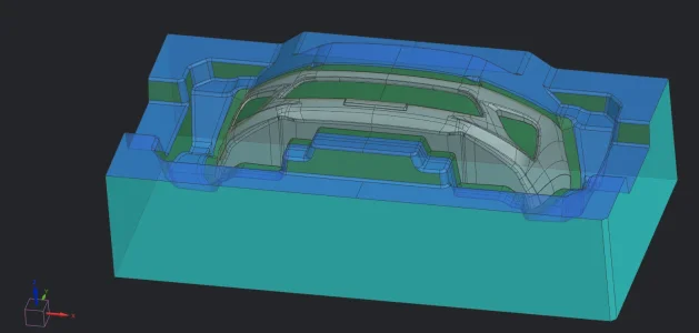

This evening I finished making adjustments to the Partingline and pushed it down to the cavity block (so far. This is ready to rough... In answer to questions about offcuts. This block is getting over 21,000 pounds removed from it. Not sure if they could do some saw cuts do to its size... Just for colour coding..
grey = part
green = seal-off
blue = clearance

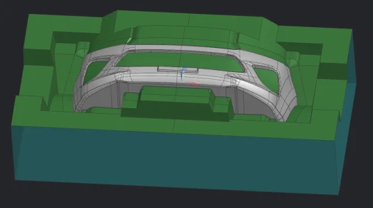

I have gone a bit further today. The core is ready to rough... I have been looking at ejection and found some examples. In all cases, they use an H pattern ejection plate with they hydraulics on the side... Also the clamp plates are cut to the same length as blocks, no overhang.. I was looking at press specs, the best I could, and this will need to go into a 4000 ton or better press... Note these molds are Chineseum, and so they are skimpier that what we build in Windsor..
All, good practice, and something to show for my design page.. free domain part-turned mold design..
Now I need to get my paying job done in the next two days before a trial license expires for Mach3 NX.. Scanned statue-clean data-miniature 1/2 scale.. very detailed.. and PAID IN FULL.

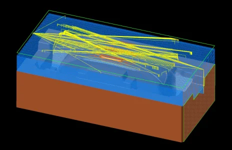

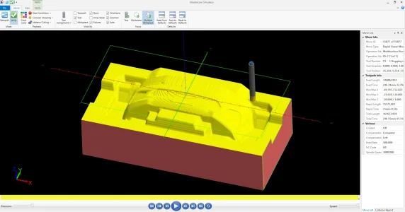

That's pretty impressive. About how long would it take to CNC from raw block form to the finished shape shown?
Matt-Aburg
Mastercam surface pocket rough with a 3 inch cutter stepping down a 0.2 / cut is about 25 hours flat out... In reality, it probably would take longer, as you would need to pick out some., change inserts, have lunch, change shifts twice.
They would like use a Parpas with 4 or 5 inch cutter and take 3/8 at one time for the initial blast.
