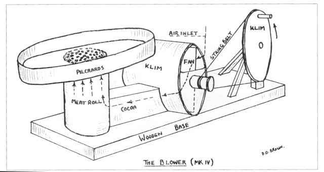

The components comprised two Klim tins (what possibilities those wonderful Klim tins offered the 'tin bashers'!), a Rowntree's cocoa tin, a Moconochie's meat-loaf tin, a Cross and Blackwell's pilchard tin, a wooden plank, some bits and pieces and some string. The finished product can be seen in the accompanying illustration.
The object of the exercise was to produce a contrivance which could bring a tin of water to the boil with a minimum consumption of wood. The principle was to force a blast of air through the kindling thus concentrating the flame and impinging it against the bottom and sides of the container, much as a blacksmith's forge works.
Its success was phenomenal; in a matter of seconds a Klim tin of water would come to the boil with the use of a few shavings of wood. Not only that, but after completing its task the remaining embers could be poured into another blower to repeat the process. Thus it was not uncommon to see a queue of two or three persons, blowers at the ready, standing by at a brew to take over the embers. In these circumstances one would hear one person ask ghoulishly of the other, 'May I have your ashes when you are done?'
In the arrangement shown, a fan blade of flattened tin mounted within an open-ended Klim tin was rotated by means of a string belt, the belt being coupled to the Klim tin handle. Due to the high ratio between the radius covered by the operating handle and that of the spindle, the fan could be made to rotate at a phenomenal speed. The rotation of the fan blade forced a draught through the 'ducting' and up through the holes in the bottom of the pilchard tin. The bottom of this tin was covered with clay to prevent dissipation of the heat downwards. Early models made use of a primitive bellows of cloth, with the operator using his finger as a valve. With time, various modifications and improvements were effected until the ultimate was arrived at in the form illustrated.
