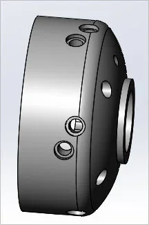

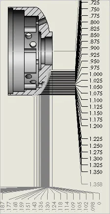

I saw that on the model engineering forum. I can think of a few applications including my radial project. I had to make 5 intake nozzles with kind of a venturi bell mouth shape. Another example is maybe my nose case which has a elliptical-ish section that doesn't lend itself to a Radii tool. I was thinking of making a 2D template, line it up under the blank & it acts as a shape stop for the cutter base. Just taking light progressive cuts. Hopefully I'll only be making one nose cases so I ended up generating a table of X-Y intercept coordinates. After roughing the 'steps' it gets filed & smoothed. But its a longer process. A gadget like that might be better for these 'analog' cnc applications, not just freehand ornamental work. Just watch the fingers LOL.
