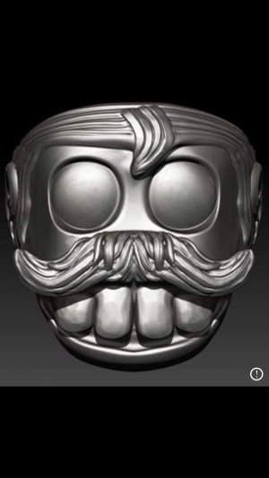

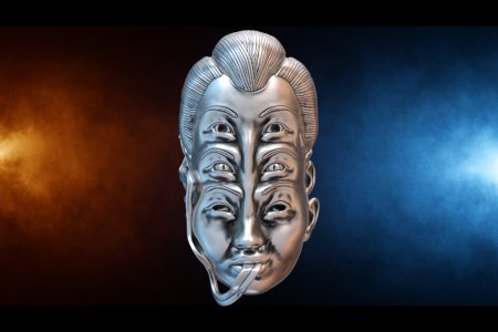

We can cast one of my designs. I won a littler or castable 3d resin.
