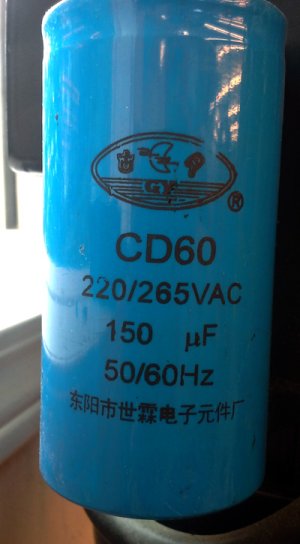

I recently purchased a mill drill machine in need of repair. previous owner had a problem with the start capacitor and removed it and tossed it in the garbage. now i need to know what size of capacitor to put into it to get it to work. I thought if someone had the same mill they could get the numbers off their machines capacitor. Any help would be appreciated .

I think I have the same machine. I took the cover off my motor cap this afternoon. Here is a picture of it:
The mill has a 2HP 1PH 220V motor (using the usual Chinese rating systems). So, 150uF with a suitable voltage (minimum 220V AC 300V peak, but higher is better). The capacitance of the start caps is not all that critical. Anything in the 100-200uF range would probably work fine. Getting exactly the right cap will give you the greatest starting torque. This cap does not give a tolerance, but -20 / +80% is pretty common for that type of cap, so getting the correct value is a crap shoot, and the value probably changes over time as it ages - especially if it gets warm.

Mine is the same basic mill-drill, but probably a bit newer - it is cream-ish colored, not green. I got is a bot a year before HOT closed. The motor has the same basic ratings, but looks physically a bit different. My motor nameplate faces the back of the mill which is up against a window. That would make it easy to look at (just go outside and look through the window), but alas, that is a south facing window, and the mill has been there for about 6 years. The motor nameplate has pretty much faded into nothing.
As long as the motor only has a single capacitor (it is a capacitor-start, not a capacitor-start and capacitor run motor), the 150uF cap should work fine.

If you just want to get it running, you can just go to any motor supply place and get a start capacitor for the HP rating of your motor. Shouldn't be too costly.
In case the motor is not original, and if you want the perfect solution: Usually the faceplate on the motor is stamped, and if you can get to it the current rating can be read if checked carefully. From the current rating and rpm the correct capacitors can be calculated for start and run.
