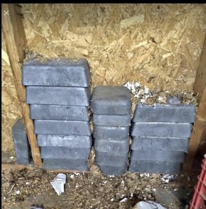

Here’s a picture from the ad.

Those ingots in Johns photo appear to b e very well formed to the pan sides so I wouldn't hesitate to buy some for bullets...but not at $2 lb. for WW alloy. I would consider $2 lb for smelter certified alloyed melt to a specific hardness alloy or Lynotype but not "suspect alloy " such as mixed WW. $1.50 lb would be tops for WW ( it would have to be very well fluxed & clean) even at that price. WW themselves can be had with some looking for $20 for 180 lb 5 gal. pail.
