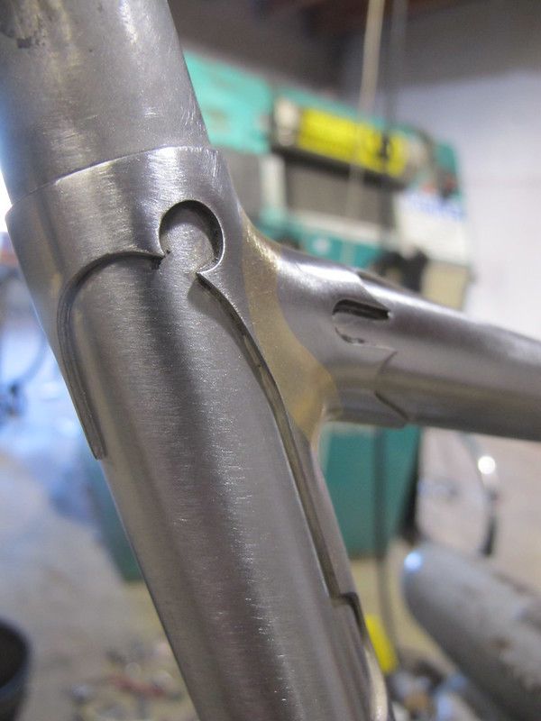

How to make steel lugs to use to reinforce and braze the tubing together in the period style. Typically these are investment cast. These don't match any of those cast items found at bike parts suppliers. I supposed I can appeal to CNC mill owners to machine me a set from design I supply. Or I can try to investment cast using an a lower melting point alloy... any ideas of suitable replacement? That would require a major investment on my part. See, I can do puns.

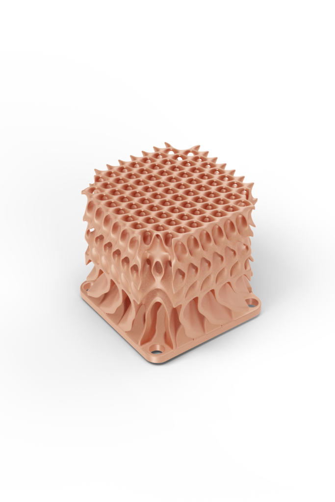

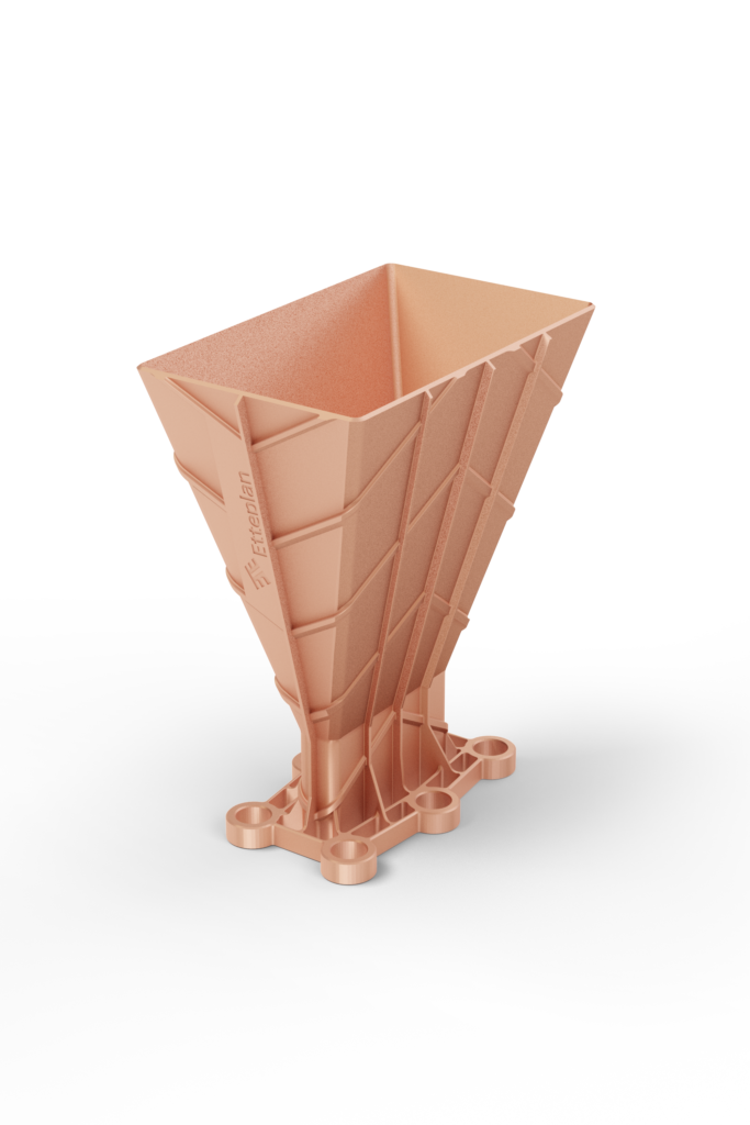

How to manufacture about 100 copper coil elements from sheet copper. Initially I was going to use a die punch for this, but when I inquired with a few edm shops none responded to my request for price to machine my die and punch. They must be busy with real customers. My mill is not really suitable for making these parts. But mybe someone with a cnc mill would want to help out?
The dies I have designed for the stator coil elements:
I also need stamped copper plates to make the electrical contacts in a compression type battery pack I am building for other ebikes I am building.
The other option is having the parts cut on a cnc router. Again something I lack... anyone want to help out here?
The battery contact plates, I already 3D printed the stamping moulds to emboss the contact points. I just need cnc router or die set made to punch these too.

I see that some builders are getting 3D metal printed lugs. Likely mucho pesos but maybe an option.
deleted_user
I already checked with my local binder jetting firm. They cater to prototyping market where firms will spend 10K like it is nothing.
This is not possible.
If I can find any scrap maybe I can try to melt ductile iron pipe in a electric melt furnace enough to investment cast?
My last resort will be to cut and weld larger tubing to weld up lugs.

Last resort? That should be your first option, not last. It's pretty straightforward to create a bilaminate style lugs with brass brazing, like Winter Bicycles. Paul Brodie has some videos on this, I'm pretty sure.
Bilam/ custom lugs by Eric Estlund, on Flickr
I know some builders also tig weld lugs from bits of tubing, and then grind away the welds for a smooth, traditional lug look, and then silver braze the lugs together. That's what Spectrum Cycles used to do when they were still building..
But I did also hear of a some guys who facilitate sintering custom stainless steel lugs in Asia. I think it ends up around $400/lug (which is why I'd be more tempted to go the bilam or TIG route).

you are right... that should be the first option. We do have cheap tig welder which should be enough to weld up lugs, but my tig experience is limited
