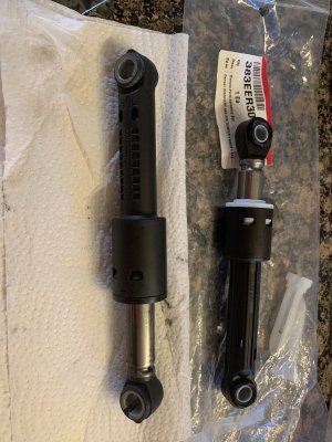

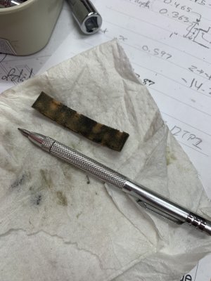

My ~15 year old LG washer is moving around on the floor and makes alarming thumps when spinning. and not washing especially well. It seems the shocks (3 of em) are not doing their job anymore. I've got some on order and while I wait the washer is OOO and the peeps are dismayed. So I got busy taking one shock apart to see how do these things work, and what's wrong with em? They're not gas shocks, instead they are more like friction shocks. The steel shaft is impeded from moving by a foam wrap around strip and "non-grease" or friction causing grease called "damping" grease. odd substance I don't know anything about. Look it up if you're curious. I don't have any damping grease but I do have regular grease and foam tape. So had a go at 'fixing' it. The foam I have is not as dense as the stuff in the shock either. The 'fixed' shock now moves more easily than the shocks which don't work so I'd say that is not going to help. I'm going to try a hobby store to look for denser stiffer foam. I need damping grease - the usual suspects don't carry it - it is on Ali with a two week delivery. Anybody know where I can get this locally (Calgary)? No the company which shall not be named after a river is not an option. (elbows up, inconvenient, slower, more expensive, yup) I need 3 small squirts. Pics follow...
I wonder if gas shocks would work? The replacement LG shocks are expensive at $47 each.
Ali damping grease.
Foam tape and shocks. One new on right and old on left.
Testing shocks
New: 4.5kg
Fixed try #1: <1kg
Old shock: 3 kg

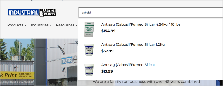

I was reading you can make damping grease by mixing fused silica into grease. Aircraft spruce has huge bags for $35 plus ship. I need 25 grams not a sack! Anybody have fused silica?
I think I'd try some of the white, shiny foam that comes as packing. Cut some disks and stack them so the shock is somewhere appropriate in its stroke.
Maybe you mean 'fumed' silica? AKA CaboSil or AeroSil. Used to increase viscosity, typically resins from a little bit to a creamy paste. I can check stock from my composites days but I may have already gifted to a friend. Its available at IP&P for $14, maybe elsewhere but they came to mind

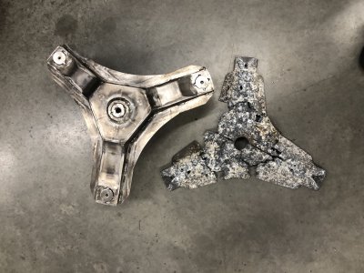

Is it a front load washer?
We have had two of them, wherein the spider that supports the drum (overhung bearing arrangement) was failing. It seemed like a soft white metal material that suffered extreme corrosion - then crack/break and allow the drum to wobble, thus be out of balance.
Yup, very common failure point: the drum mounting spider.
New and old (drum side)
Old and new (with static balance weights, spindle drive side)
Miele uses the same sintered white metal which turns into dust over time. One could get a replacement from Miele for $1.2k + at the time. There is/was a Ukrainian company selling stainless steel replacement spiders for ~€125.00 + shipping. Problem is the war.
So I ended up making my own spider from SS. Still works well after 2.5 years.
We initially thought that the shocks were gone; it turned out that the spider was failing and causing the severe imbalance. The shocks are just fine.
Machine is 20 years old with no failures of any kind (other than the spider).
