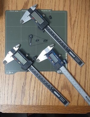

I was looking for a 3D print project and came across this caliper battery saver. It look like simple solution , compare to some modification I have seen were they wire in and mount a micro switch. Here is the link
The print only took 8 minutes, then I had to deburr and file some edges for a proper fit and it works like a charm on my Neiko caliper, so I printed a second one.
For my mastercraft caliper I will have to design my own, the data port cover is totally different. But if you look closely the mastercraft caliper it has a 3D printed battery cover. That was my very first 3D print I did. I didn't know anything about 3D printers, CAD, file type ............ Found the STL file example in printables.com and gave it a go and it worked. That when I first fell in love with this little toy machine.20241129_220119.jpg

Because I’m cheap, and don’t have a 3d printer, wouldn’t a piece of stiff nylon or acrylic do the same job as the slider?
I usually pick up my 357 battery pack from the dollar store, maybe that explains why they don't last. They usually last about 6 month to a year, it's not bad. I was just looking for something to 3D print and this one was quick to print and install. I have read some complaining that their calipers would quickly drain batteries and went to the trouble of installing switches to completely isolate their batteries. I thought this quick 3D print might help some with this issues. Yes a stiff plastic carved to the right profile would probably work.
