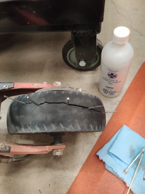

Family member brought their electric Scooter over to see if I could repair the rear tire.
The repair is meant to be temporary until the replacement tire is available.
They use the scooter to get to work where parking is a nightmare.

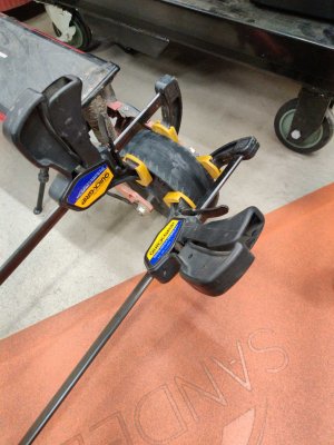

Opened up the crack with finishing nails and cleaned with Isopropyl alcohol.
Injected as much adhesive as I could into the opening and then clamped it together.
30 seconds for initial bond and 24 hours to fully cured.
I will leave it clamped overnight.

Just heard from him regarding the scooter - first trip to work and the tire repair held 100%. Interesting on 2 fronts - the repair held up and will this delay him getting the replacement tire?🙂
