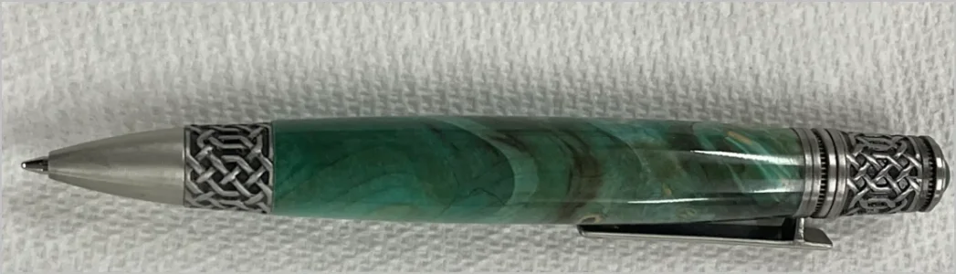

My first two pens with CA finish. I've been using CA as an adhesive for models for +30 years but never considered as a coating system. But after seeing so many examples I just had to try out of morbid curiosity. I think there are better finishes but its the rapid buildup of glue + accelerator. Doing a regular clear coat would take much longer.
I went to polish on Green too soon. The picture looks better than real life. I can still see the rolling hilltops of the glue lines that were not blocked down to the base of valleys. But I kind of messed up the wood diameter which was already proud of the pen body diameter & was getting concerned my CA application was too thin in that area so I stopped. On brown burl I applied more coats & blocked with 600# between coats & that helped. More thickness to work with & a better surface to start sanding. The trouble with pens is if you want to sand in a different direction to the rotation axis (longitudinally), you risk making facets which is even worse. What I find works best is a foam rubber pad backing with the right amount of flex. And as mentioned above, fine grit scuff pads have a nice way of conforming to surfaces.
