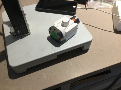

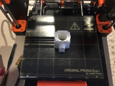

To make something simple like the image below, it takes about 10-15 minutes in Altium, another 2 minutes to slice it and another minute later it's printing. It's so easy that that I made a mental note this morning to think before hitting the print button, the initial version of the image below that I printed yesterday I blindly copied the 5.5mm holes from the ballscrew drawing instead of making them 4.2mm to be threaded for a M5 screw.
