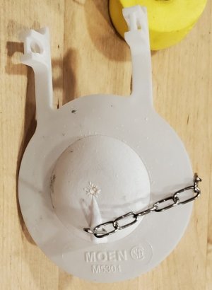

My wife has been complaining that the toilet has been making a squeaking noise. With my poor hearing, and even with the hearing aids I kinda heard it but the lazy part of me was pretending it wasn't there.
However, there were other noises I couldn't ignore.
After a bit of thinking I decided it must be something with the flapper valve leaking ever so slightly and that caused the fill valve to open ever so slightly with the slight squeak.
Well... Turns out the MOEN 5304 flapper valve is crap.
Clearly the white plastic molded over the translucent rubber is crap. The ring isn't centred and there is a rough area at the left side.
Well I happened to be at the RESTORE place the other day and spotted a complete toilet rebuild kit with the long arm and ball float for $10. Along with a replacement flapper valve. Seeing what the MOEN looked like I trimmed the flapper to fit the current arrangement and installed it.
I will have to check with SWMBO to make sure it doesn't make that noise but I think it's fixed.
Such a simple solution.

Y`'know, given the depth of the part, vs. the short distance between the pivot and the actual plug, I'd gravitate towards the 'wrong'(crooked), rather than the right.
Prolly less to do with it being off center, that about a failure to seal as may be accounted by a great many reasons...

It came as a kit. I removed the tank. Washed it out with the hose outside. Bolted in the drain assembly when the tank was bolted back to the toilet seat. Never even looked at the underside of the flapper valve.
Might not be clear from the photo but the flapper is very defective. It's that white coating over the translucent rubber (Plastic?). Anyway, it's the white covering that is off center and has overspray and roughness. At first I thought it was a calcium deposit. We'll see if MOEN replies and replaces.
Funny thing is the kit I bought at RESTORE for $10 has the more normal black rubber flapper.
