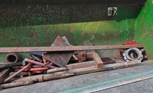

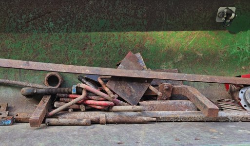

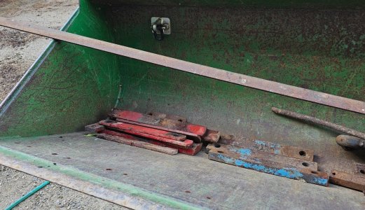

I often mention finding old farm equipment to scrounge metal from in the bush or in a farm yard. A neighbour called me over today. He has a trailer loaded up to go to the scrap yard. He told me to help myself. So I did.
A lot of it is old and mostly mystery metal but it will be great for the kind of stuff I do. Might even end up back on his own equipment some day!
That long piece of 1/4 x 1-1/2 on top will make lots of perfect screw cutting coupons. Maybe even a full set? I'll set it aside for just that purpose. Maybe I'll even finish that before I fill a big hole someplace......
