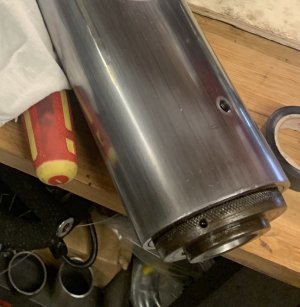

Thanks for this. I got 3 of the four from local supplier Peterborough Bearings ($327 CAD) and the forth , apparently an oddball is on order from from H&W Machine Repair and Rebuilding (hwmachinereapir.com) in Ft. Wayne IN. for USD$212 + so your estimate was good. They apparently come pre-packed so no place for me to mess up there.
As for the oil seal, I'm still trying to figure out what that's all about. I've attached two images taken from P. 20 and 21 of the 602 Manual I have.
They first shows the taper and a part # 52-11903 which the second image , a parts list identifies as a Seal Ring.
I couldn't get anything from the bearing people and don't even know what it is I'm looking for. I just know having removed the spindle, I don't have it. Any suggestions?
My machine is R8 so slightly different but what they call a seal ring is a slightly knurled cap of sorts at the bottom of the spindle. Not sure if there’s any rubber or felt sealing element in it, it’s been a while since I had it off on mine. There shouldn’t be any oil in the spindle so it’s not a seal to keep oil in.
The oil seal that keeps the oil in the gear box above from running down into the spindle is the one I pointed out in my earlier post. It’s pressed into the bottom of the gearbox. Item 116 here:
