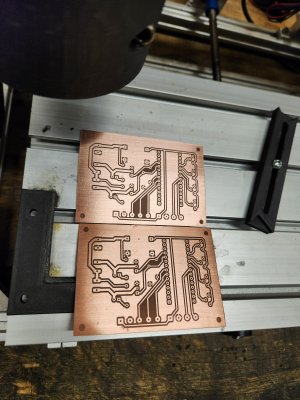

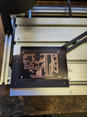

Only making simple things, but Kicad and Lightburn. I coat the boards with paint, burn the outline of the traces with a 5w hobby laser on a 3018, then etch. Makes for pretty quick in-house prototyping. A silk screen works pretty well for applying and even layer of UV cured solder mask...burn the pads off with the laser.
