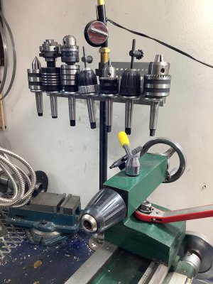

As to the tail stock on my lathe; I find that when I use larger drill bits in my chuck they have a tendency to spin in the chuck . As a collet grips bettter then a chuck I was considering using one in lieu of a drill chuck in the tailstock. I do wonder if that may only transfer the spin to the shaft of the collet holder within the tailstock taper. I might get a collet holder with a tang and see if that works.

I have used it before just as you describe for larger bits, if I have a few to do I setup the larger bit in the collet and use the center and pilot with the drill chuck then swap out for the final drill a little faster, convenient. As for spinning the only times I have spun it was when I was still learning/pushing limits and I put the blame on myself, as I have become wiser with pressure and alignment I haven't had that happen in a long time.
A tip that I learned, if your tailstock won't eject the shorter taper as it doesn't have a tang, I install header bolts in the end, I have a few hanging around from my first childhood. 😎

Please explain that a bit more. I have no idea what you are talking about. But it sounds like something I should know.
My 10" South Bend won't eject a taper if it doesn't have a tang on it and I have to remove them by using a wedge. But if I put a header bolt in the threaded end it's head is small enough to allow full insertion and allows the tailstock to eject the taper. Assuming that the thread is imperial.....
Changing bits? Pshaw…
From left to right:
live centre
live centre with 2” 3-jaw chuck for big stuff
live center with drill chuck for small stuff
keyless chuck
keyed chuck
keyless chuck
keyed chuck
keyless chuck in tailstock
one chuck has a semi-permanent centre drill
holder is a chunk of aluminum tubing with some 3/8” eyebolts. Eyebolt eyes are bored to a slip fit over the MT2 shanks so they fit flat against the back of the heads
Stand is 1/2” NPT floor flange, 1/2” x 18” pipe nipple, 1/2” NPT union, 1/2” brass fitting drilled for a slip fit on the shank of a tensor lamp (not shown). 1/2” NPT u-bolt connects the stand to the holder.
You can hardly tell I spent 43 years selling industrial piping
Set up all the bits at once, when I’m step drilling I just change complete chucks instead of opening and closing chucks,
3/8”-24 UNF x MT2 shank adapters cost about $15 off eBay or Amazon, and when I’m at the Value Village Boutique I can usually find dead cordless drills for $10.
Tangs for drilll chucks, drawbars for live centres. On the far left live centre if you look closely you can see a socket-head cap screw on the end so it will eject from the tail stock quill as per 140mower.
The live centre chucks are mounted on MT2 x M12 and MT2 x 3/8”-24 UNF shanks from eBay
