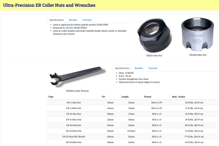

Use caution when getting the replacement nut, the Mini Nuts may have different threads:
No worries, I don't want or need a mini nut anyway. I just wanted a bearing nut and I doubt they come in the mini size.
