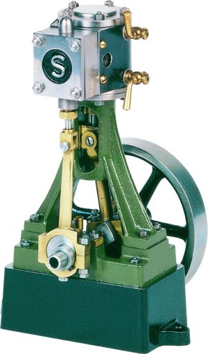

I'm going to use 4-40 studs and nuts for my 10V steam engine. The problem is that regular 4-40 nuts are not to scale for the engine (way to big) so I'm going to try my hand at making the nuts with 3/16 hex stock tapped to 4-40. I know there will be a lot of waste just in parting the nuts to the correct width but I don't think the world will end tomorrow so I've got the time.:)
Got a link to the steam engine kit or are you working from drawings. Sounds tiny? Where are you finding hex stock that small?

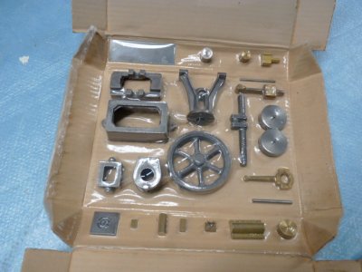

The kit with british BA nuts and bolts so I could have just bought the BA tools, but for what may be a one off project buying a new set of tools didn't seem practical.
That’s a nice little engine how far have you got so far any problems?
I've just started to clean up the castings and have been watching videos of other peoples builds.
I'll start a thread when I get a few pictures start machining.

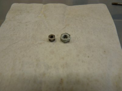

Here's a pic showing the difference between a standard 4-40 nut (right) and the BA nut (left) that came with the kit. The 3/16 hex stock I have is only about .015 larger than the BA so I don't think any one would notice and I can make matching bolts where needed.
I'm not even sure the standard 4-40 nut will fit in a couple of the tighter spaces.
BTW - A 3/16 5C hex collet from Hardinge was going to be $167cdn so I ordered the $65cdn one from Amazon and it came in today. Some of the reviews said the collet was small and they needed pliers to get the stock in/out. This one seems to be fine, it's snug but can still be adjusted by hand. Now comes the fun part, making a nut.:)
