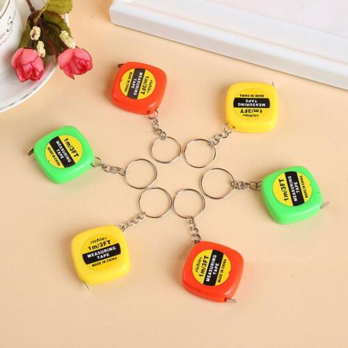

Only about 5mm wide.
a section from one of these, with some CA glue and tiny rivets
