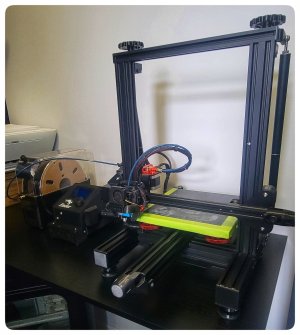

My unreliable printer in the picture(on the left) and then the Ender3 on the right:

I will look at that ali store, because I can't find what I want more other places when I look. Creality doesn't seem to have ender 3 max dual z kits. I looked at two other direct drive units and both had parts no longer available and the updated parts no longer fit the systems. Very frustrating for me at times. Looks like your printer has auxiliary braces which seems wise if you want increased speeds too... are they from triangle lab?
IIRC the dual z kit and braces I got from amazon.
I don't try and print fast speeds, anything normal usually PETG @ 50mm/s with a .4 nozzle, .4 layer height and .8 layer width which saves a lot of time. Temperature, whatever it takes to keep the extruder from skipping which is usually 275 for me. I also run a hardened nozzle so I think it's less efficient with the heat vs brass
