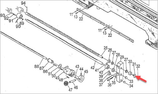

My current idea is to make a new end block for the C0636, that will permit an adapter for a standard Dewalt drill with a clutch. I intend on calibrating a specific drill and use it to power the leade screw. It seems sensible to use several specific and repeatable cutters, for several depths, in several materials (at a specific diameter). The academic would also test a bunch of diameters for completeness...
FWIW I am choosing a C0636, as it is popular, and the results might well inform the other models in the 14 X 40 category. For those with 13" or 12" lathes, it might be reasonable to assume that our results will translate, modified, to those lathes as well.
Excerpt from C0636A manual. I believe the Neanderthal over-torque prevention is via the shear pin within the coupler. You could substitute weaker materials against a common feed load so it fails earlier (and safer). But you would be limited by individual material strengths & I suspect dodgy data relating to meaningful numbers. If you could somehow adapt a maximum recording strain gauge in that area, might be more accurate & repeatable? Sorry, instrumentation is above my pay grade.
Not familiar with the lathe details but could you engage your drill/clutched/measuring adapter into what appears to be a threaded hole in shaft end?
(Not quite sure what the fastener does though & would only work in one rotation direction)

On a C0636, there is a plain rod at the end, approx 7/8 in diameter. there is a hole for a centre in the end o the rod.
Mine has a threaded hole in the end with drive flats.
