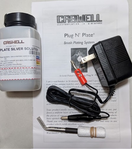

I bought a Caswell kit to do nickel. They sell quite a number of different metal plating kits.

Are you thinking the Brush style? Because the dip format will provide an even coating no problem, the only inhibiting factor is the size. I have Caswells Nickel and gold in the dip format which, with a proper power supply provides a beautiful finish.
I just ordered the brush style and read online that the finish depends on the surface preparation of the piece before it's plated. What is the size of the dipping tank? The working area of my fiber laser is 150 square mm which is almost exactly 6 sq inches so would a piece that size fit into the tank?
I had bought the nickel brush type. Made a dip tank from a glass bottle and used a similar transformer like in the kit. Used it to plate a piece of Invar for my telescope build. Plating is not straightforward, it is an art due to all the variables.
