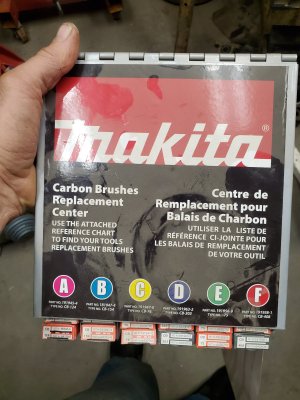

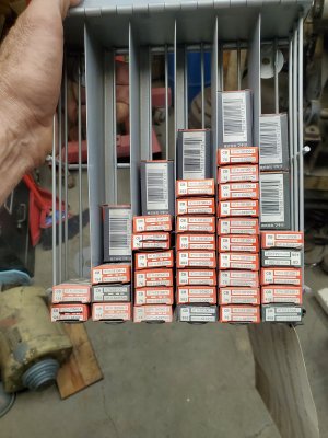

Most of my brushed tools are Makita, no problem getting brushes, about 7 bucks a set from Makita. I did have to change a set on a Bosch tool recently, i was shocked, i think it was 20+$ for the set, but in any case still available
View attachment 59526View attachment 59527

Okay... So I followed the instructions "Use the attached reference chart to find your tools replacement brushes". Now what? Are you going to post a phone number to call? What is the ETA and warranty? What kinda reviews are you getting? Do you accept 3rd party cheques?
