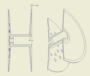

I make some fly reels which have a shallow (4Deg to 8Deg) taper on the flanges. I try for a mirror finish without having to polish after the parts come off the lathe. Turning the compound by hand without leaving any tooling marks is a PITA.

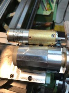

I found a couple of small 27V DC gear motors in my collection of "useful someday stuff" - always good to have backup:)

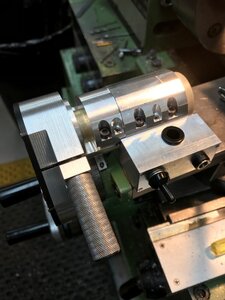

The whole assembly is secured to the top of the compound with 4 8-32 socket head caps.
Since the motor is DC it can be reversed. Although the motor is rated at 27VDC I've run it from 12VDC to 40VDC. All the voltage change does is change the compound feed rate. So far 27VDC seems just right for a near mirror finish.
The idler gear train pivots on the motor centerline to engage or disengage the gear mounted on the compound handwheel - effectively turning the compound feed on or off.

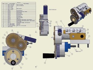

To be clear - I did not make the gears. I purchased them from SDP-SI - https://sdp-si.com/. I then bore/face them as needed to fit the desired assembly.
The gear train design was a bit tricky because I didn't have a variable voltage power supply on hand. This meant that I would be stuck with a feed rate dependant on the gear ratio selected.
So these are the design steps...
- determine compound feed rate to produce near mirror finish at appropriate lathe R.P.M. - I'm turning these at 200 r.p.m.
- measure gearmotor output speed at rated input voltage 27 VDC (and a few voltages above and below rated voltage)
- pick a gear ratio that fits these criteria
- pick a gear size that will fit on the compound hand wheel
- pick a gear size of the correct ratio to fit the gearmotor
- design the housing to provide clearance between the drive gear and driven gear
- design the idler - I originally considered using change gears on the output side of the idler but found I didn't need to.
This was really just an excercise is packaging the correct components.
I don't recall the exact compound feed rate but I think that I ended up with somewhere between 0.0015" and 0.002" compound feed per revolution, which gives me the desired finish. I can use a 40VDC supply and turn at 300RPM to save a little time roughing the taper.
