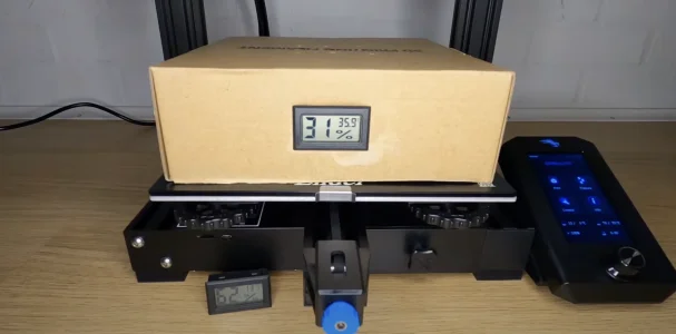

I love solutions to problems which involve a cardboard box - i.e cheap as hell. You may have seen my spray booth. In this vid - link below - a maker, Ricky Impey, has fabbed a filament dryer. Reuse the box the filament came in, cut off the bottom, poke 9 holes in the top, and then you put the filament under the new box 'lid' and turn on the heat bed on your printer 70C. Wait. Monitor. Love it. The little electronic humidity gauges are cheap on ebay or amazon. Ricky you rock.

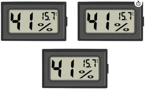

Ideally .... zero!? I'm not sure how you get there exactly. Vacuum chamber? Freeze drying? Practically speaking I put a roll of nylon in my electric dryer with one of those humidity meters (as seen on the cardboard box). I ran it for 8 hours and the humidity went down to 15 or 20 from 35 or 40%. That seemed to work. I bought a five pack on amazon for various uses. In the fridge, in the shop, etc. @David_R8 see I snuck cardbox box in there along with a photo? omg I better stop before someone thumps me. :D
