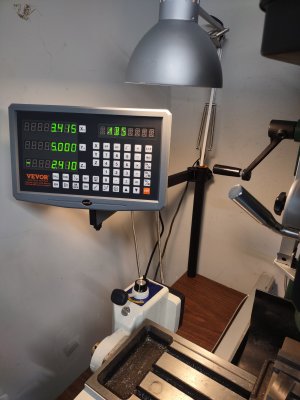

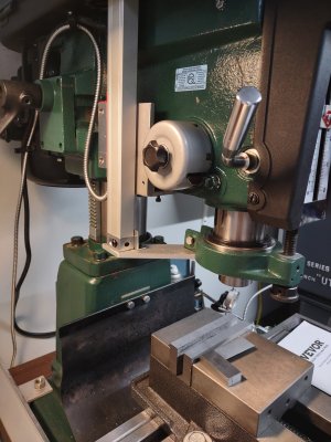

Finally got a chance to install the dro on my RF30. Eventually I will look at putting touchdro on it some time in the future. I did not cut the scales and opted to cut the belt guard for the z and just use the long one on the y axis. It's a vevor set that came much longer then I thought but it fits mostly. For the z I flipped the casting that holds the depth stop and cut a piece of 1/4 aluminum plate. Some angle pieces from the junk pile and it came together over a few nights. I first started out way over thinking it all.
View attachment 59021View attachment 59022

Does the x-axis scale doesn’t interfere with y-axis range? It looks like it sticks out front by quite a bit. Just concerned there’d be interference that would restrict outward movement o& the table…
I’m curious about the X power feed.
All the mill drill table X power feeds I’ve seen are horizontal.
I’ve never seen one mounted like you did.
To be clear I’ve never seen lots of things.
Would you please post what make & model it is?
BTW the one in the photo is on my RF-31

No interference, full motion on all axis. Might be the picture angles I can take some more pics if you wanna see. I looked at the install from the minimalist don’t over think it angle. Not much fabbing, the most work was the z axis mount and me deciding how I was gonna do it.
Originally I built a drive out of a wiper motor and a socket hex nut kind of setup. It didnt work well so I looked for an actual drive. I would have liked to find a horizontal drive for the x axis, but could only find the vertical ones, I think it’s for a knee mill. It was the cheapest I could find at the time. I had to turn down the bearing mount on that side to fit the drive and then filed the cross screw end for a grub screw. Lathed the drive gear to fit and cut it short. Works as expected. I copied some others that have done similar. Most I have seen mount it on the right but my lathe used to be real close to the right side so it ended up on the left.
The drive is this one.
The dro kit is this one.
That style was more common on the lighter duty mills. I had one on my RF45. The mounting was a bit simpler with the angle bracket attaching to the table. You can still get them. It also has some disadvantages but they work
