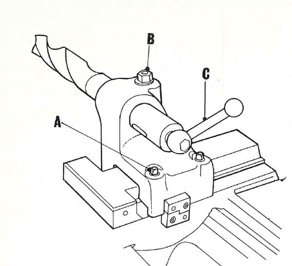

To take that idea a little further, Dean Smith and Grace have a fantastic arrangement for carriage drilling - an accessory that clamps onto the cross slide dovetail. With a stop on the carriage, tools are automatically aligned with the lathe axis and its a very solid setup
I'd thought this a great accessory to make.....or if anyone has a version for a 13" DSG they want to sell, I'm a buyer :)

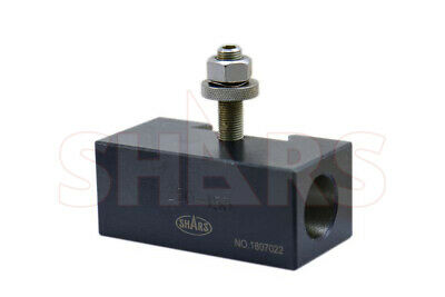

I have done a little drilling using my carriage and an MT2 tool holder in my QC BXA tool post. The only reason I did that was to be able to use an MT2 drill chuck instead of the tailstocks MT3. I didn't have an adapter.
Basically, I didn't like it. It was WAAAAYYY too fussy with a lot less rigidity (VS the tailstock) for my liking.
At the time the stock chuck that came with my lathe was MT3 and I wanted to use a better one that had an MT2 arbor for the job I was doing. I didn't have an MT3 to MT3 adapter at that time.

The trouble with MT holders on a BXA Tool Post is that they have to hang out there a lot further to make room for the MT3 Socket. We all know what more hangout does. But even without that, there is no way a tool post composed of a dozen parts between it and the ways can ever equal the rigidity of a big fat tailstock attached directly to the ways......

It depends (imo) on the size of the drill. I've a few small lathes used for small holes with levers and agree, it is absolutely the way to. Easy to clear chips, more sensitive and faster. But they they lose their appeal as the drill size increases. I don't they'd be much fun over say 1/2"
For large drills, the DSG rig is (imo) the best. For punching a 1" through a length steel, the tailstock is obviously doable, but rapid retraction for chip removal, power feed and removing the chance a taper drill spinning in the tailstock quill would be nice The tool post gives some of these advantages, easier to retract, and power feed, but needs alignment and creates a moment around the tool post bolt. I've not used one so can't be certain, but wonder if that becomes an issue with large drills?
