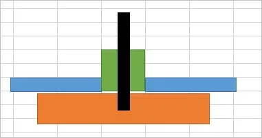

For my RC build I am going to be making some sprocket mounts for fitting to a shaft. Here's what one of the sprockets look like:
So I need to make a small mount with at least 4 bolt holes that will line up with the holes in the sprocket but I don't have a mill (yet). I do have a drill press though.
I was thinking I could just make a simple jig where I use one of the sprockets as a template to put a pin on a scrap steel plate for the center and drill 4 holes, tap them (so I can securely pin the parts in place), then use the template to locate the holes on the sprocket mount and ensure spacing while drilling on the drill press.
Needs to be fairly accurate as these will be spinning at upwards of ~2000rpm, material will be aluminum.
Any better ideas?
A slightly more direct way if you have lathe. Make a dedicated drill guide that has OD to snugly fit the sprocket hole ID. Guide also has a pilot hole from which to drill directly into your part. Ultimately you would open up these holes to whatever fits in there, dowel pins, threads for bolts. Or maybe depending on size required maybe you are home free right there. It might be beneficial to make 2 identical drill jigs (from same stock while in the lathe) so you have one to index & hold on hole#1 & the other guide to drill the reminders from hole to hole. This isn't much different than transfer punches, but those are only as concentric as the shank OD happens to fit & guessing the sprocket is rather thin.

Do you have a 3d printer?
If you did I'd print a jig that has a concentric boss that drops into the shaft hole and at least one detent that interlocks with a sprocket. Print the concentric hole array to use as a guide in the drill press at the nominal drill size. That will provide a tight fit for a drill and assure concentricity. I could print up such a part in 20 minutes or less.
I have also just laser printed markings on paper and then carefully glued that to the material being cut assuring it is as concentric as possible to the part. Then a center punch and just drilling

Never thought about using the 3d printer to make the jig, that's a great idea!
(I have an Creality Ender 5)
