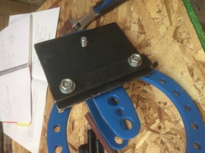

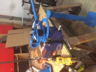

Thanks guys for the kind offers. I don't know where to locate these things. So for now I made bases for the benders that I can clamp into my big 6" bench vise. I need some kind of post that's flexible and will accommodate both of them.

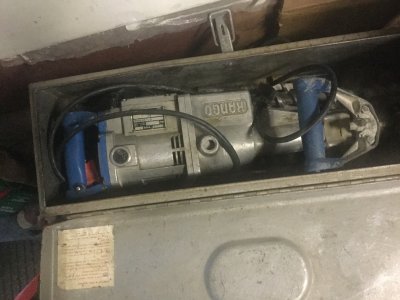

This is sitting in my garage waiting to be used. Smallest bit I have is 1" though
