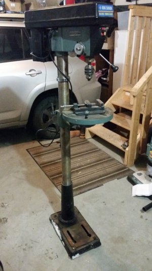

Hey guys, I'm in the market for a drill press and am trying to find a good deal on Kijiji, but it's easier said than done. If I decided to go new, what advice do you have?
How much do you want to spend? The addition of an xy vise is really handy on mine. Look for a good range of speeds. 300-3000ish. The floor mount ones have a lot more space to put a vise, and work, and the bit. I have the porter cable one from lowes. The good: It has a nice 1hp motor, it's powerful, the belts are easy to change speeds, it is sturdy and heavy and pretty rigid, and it was cheap. The bad: the supplied chuck has run out, holes in metal tend to be a bit oval. It needs a better chuck. I also have a ryobi one from Home depot, quite inexpensive, works well - better than porter cable with very little runout. However it's too small to fit parts, drill bits and the xy vise all at once. So it tends to stay sitting on the floor.
