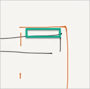

I do a lot of work with electrical junction boxes, and always need to drill holes for conduit connectors. It’s always a PITA, the boxes are too flexible to stand up in the drill press. So the holes tend to drift from the intended location. And my various sheet metal punches usually don’t have enough throat depth to reach.
So I’m thinking of fabricating a new table for my drill press, with a triangular table. This way I could hang the junction box off the table from the junction box side that I am drilling.
Kind of like cutting back the table as the red hatch marks on the photo. My thumbnail sketch of how the junction box (red) could hang off the drill press table (black)?
Any thought on this? Anyone else run into this problem?

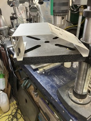

Here's an example, and how I do this now. I swing the table off the centre line, lay down a chunk of scrap wood, and drill. Problem is often the junction box is smaller than the table. Works OK with the first picture, I can drill on the crosshairs, but won't work with the second picture when the box is too odd-shaped or too small to sit properly.

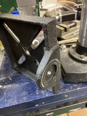

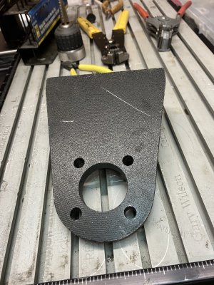

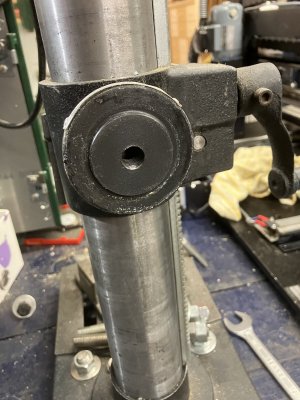

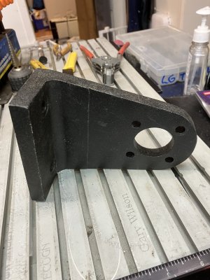

But, one way to solve a problem is to ask people smarter than me for suggestions. @David_R8 's idea would work perfectly, but my drill press is a piece of crap and the table doesn't have a centre post. Ahah! moment, dug out a beefy aluminum bearing bracket out of the leftover-bits pile. I'll machine the back of the bracket to mate with the drill press trunnion, and cut the bracket down to make my vee nose table. Easy enough to swap tables when I need to drill boxes.
