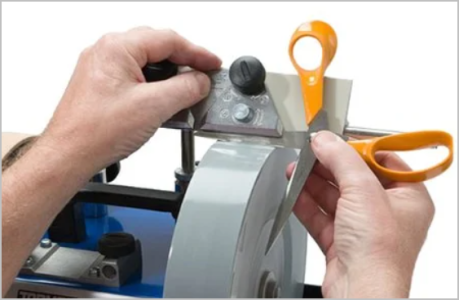

Scissors/shears.
Tormek makes accessories but its an expensive setup

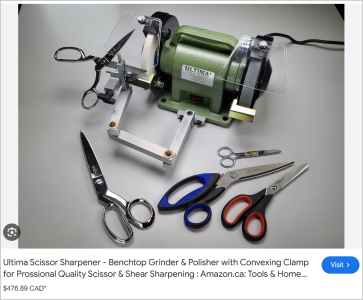

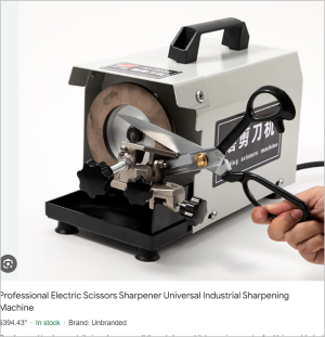

My gut tells me these are kind of mid range 'gadget' jigs. Better than an uncontrolled, unconstrained hand, but not Pro. Some endeavor to get the speed down, others are rebranded bench grinders from what i can tell.
I think these low speed lapping plate/wheel might be closer to industrial standards. And like drill bit sharpeners, looks like some clones have entered the market.
I have seen home shop machinist people like us make similar machines for lapping tooling, scraper blades etc. The jigging is different but similar principle
