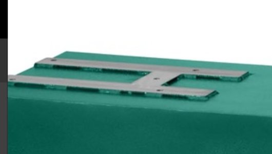

As for the stand, my lathe is tiny (10x22), and the stand they sold for it is made of very thin sheet metal, so that anything would be an improvement over that. 🙂 As for levelling, I have given it a lot of thought and intend to do something similar to what James over at Clough42 did on his Grizzly 602, which is very similar to my CX706. Also, his lathe sits on a wooden bench. I figured a solid couple-hundred-pound steel frame with a thick steel top would be a lot better than that. I may look into filling the tubes with EG, though, if it adds more vibration dampening.
I like what James did, but I would probably replace his aluminium plates with steel of the same thickness. I didn't do any analysis to support that, and I don't think he did either. But to me, it only makes sense to reduce any bending in the bases associated with aligning the lathe.
You could also defer a decision about adding EG to increase the stand rigidity till after you see what it's like without it.
100% agree. I already bought two pieces of 5/8" x 6" x 12" steel plate in place of the aluminum. 🙂 The thickness was what was recommended to me by the folks at Beach Road Steel where I bought it.
You might be overbuilding it for a light lathe - zero need for EG for such a lathe (imo).
As an alternative, my standard bench (made 8 or 10 of them so far) is 1.5x.1.5 x 1/8" HSS frame with two sheets 0f 3/4 ply glued and screwed together on top. height to suit, usually 24 x48" foot print to maximize yield from plywood sheets. Welded clips (bits of angle iron with a hole) on the HSS and wood screws in the top. I usually have one shelf half way down support by HSS. It keeps it light and easier enough to move about.
Super easy to make and I have lot of light lathes sitting on such benches ... they are more than solid enough. These small lathes just won't generated the vibration or forces to make it an issue. Biggest I have is on such a bench is the 102, last photo, again, zero issue.
