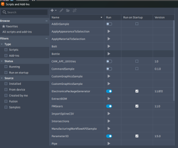

There's an add-in that allows this.
Search for Fusion 360 and look for a post by GerrittV
I think he means the hobbiest version which doesn't support add-ons. You have to pay to get that. I wish it was otherwise. I'd love to be able to do stress analysis.
So why did you suggest an add-on then? I thought you couldnt get add-ons with the personal version. If you can, I might need to buy some confetti.
because you can use add-ons with the free/hobby/personal version. I use it myself.
Sorry, they are officially called add-ins, not add-ons

Sorry, I didn't see your post till after I posted. Time to order some confetti!
Does that mean the "Add-Ins" are free for personal use?
