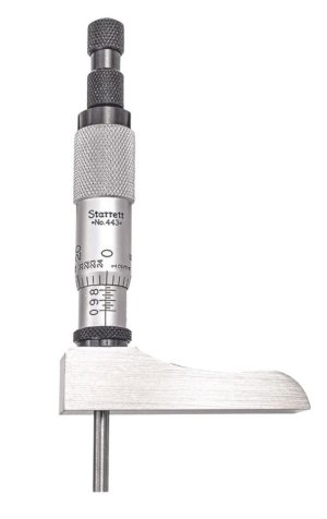

The Starrett is an inside mic not a depth mic and it looks like there are a few empty rod spaces in the case.

The lufkin in a wood box is nice. The starrett isn't a depth mic..

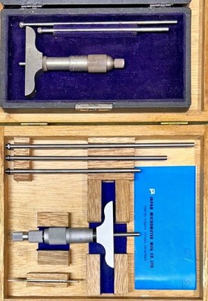

I have a Craftsman 0 - 3” set and a “Japan Micrometer” (NSK) brand 0 - 4” set:
Photos:
Eventually, I will modify the Craftsman into a half-base:
