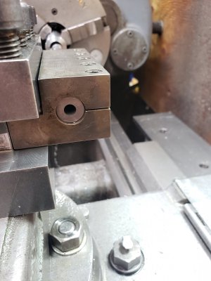

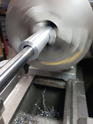

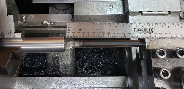

I had to bore out a piece of AL6061 to 0.740". Used a 5/8" carbide boring bar. 6" depth, that's 9.6:1 ratio. No chatter, [email protected]. It was a pretty tight fit! Finish isn't great, but doesn't need to be on this project.

Guessing some of the finish observation was the result of swarf bunching up behind the bar.
Is the boring bar carbide or just the insert?

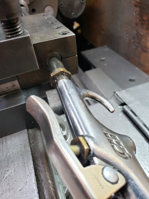

It's a carbide shank with coolant hole. I blow compressed air through the hole to clear the chips.

Ah, I see! Very cool! Does the air blowing through the shank act like a venturi to pull extra air through the tube too? Or does it just go everywhere?
